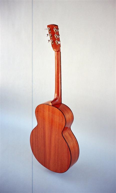

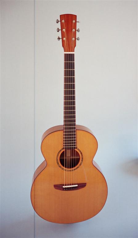

PostPosted: Sat Jun 23, 2007 11:14 am
curious if anyone has any pics of a completed guitar.
PostPosted: Sun Jun 24, 2007 4:58 am
Posts: 260
Not very good pictures I'm afraid, but here are a couple.
               Peace, Paul
PostPosted: Sun Jun 24, 2007 5:58 am
kinda looks like mahogany....
PostPosted: Sun Jun 24, 2007 7:49 am
Posts: 260
It is about the same color as Mahogany, although if the pictures were better you would see some fine black lines in it that Mahogany doesen't have, and the pores are smaller. It is somewhat plain but it takes a nice polish and makes a very nice sounding guitar. Not high zoot, but a very good tone wood IMHO.
                       Paul
PostPosted: Sun Jun 24, 2007 8:26 am
Nicer looking wood that I would have expected... very nice guitar Paul.
